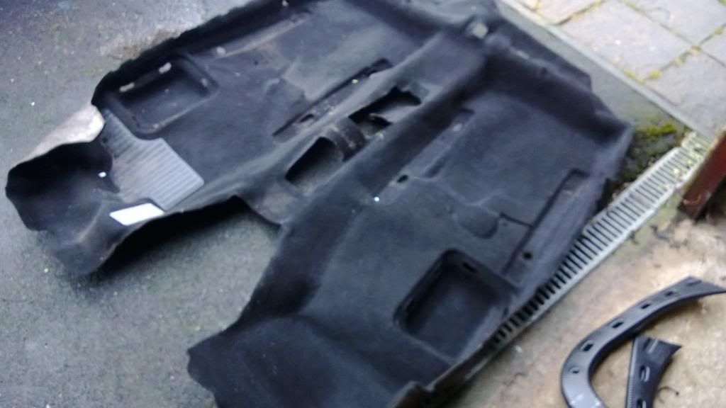

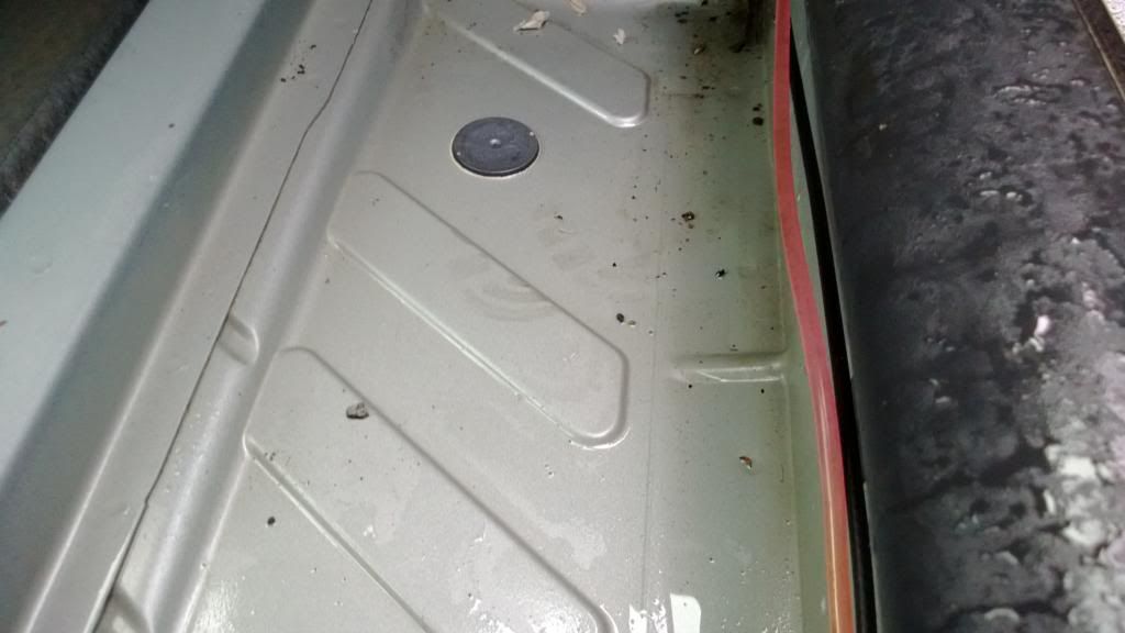

      After experiencing condensation on my windows recently, noticed by MaxiTBird, I followed his steps of removing the seats, center console, carpet and foam.

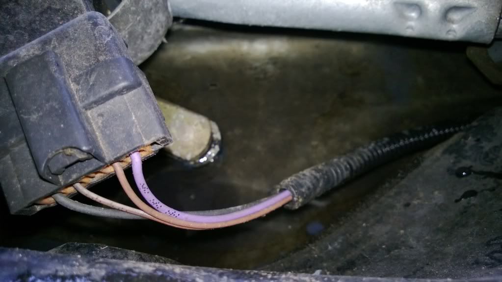

      Scuttle Drains

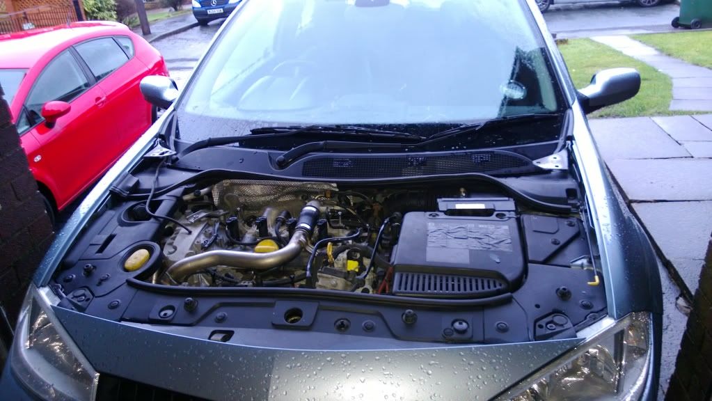

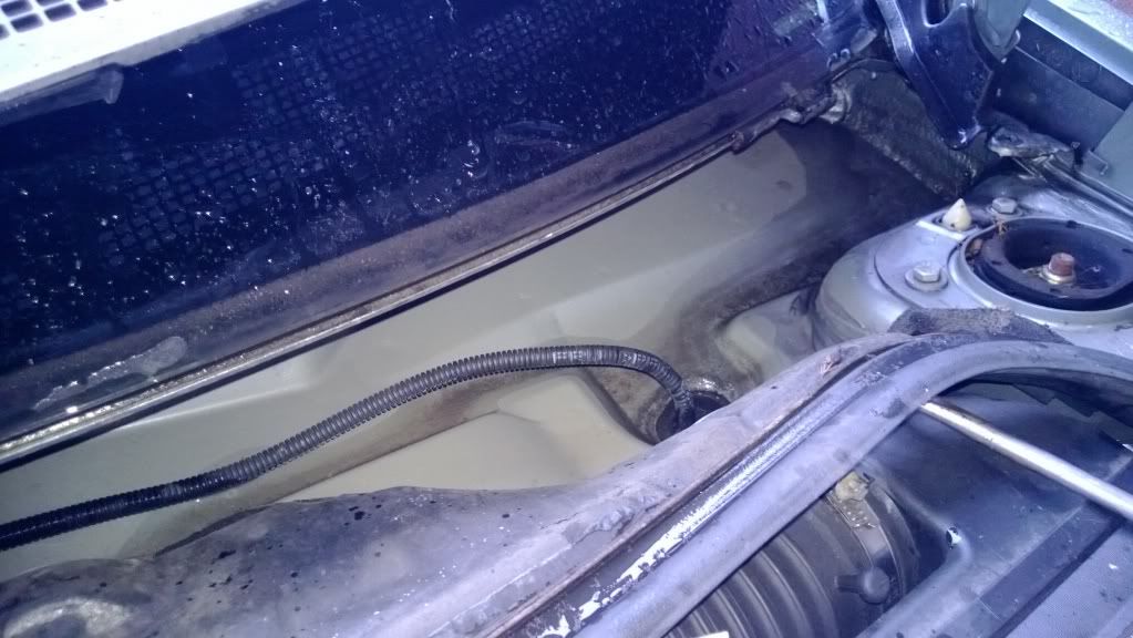

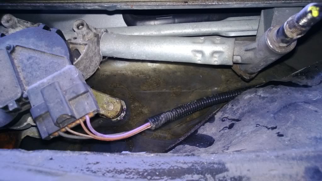

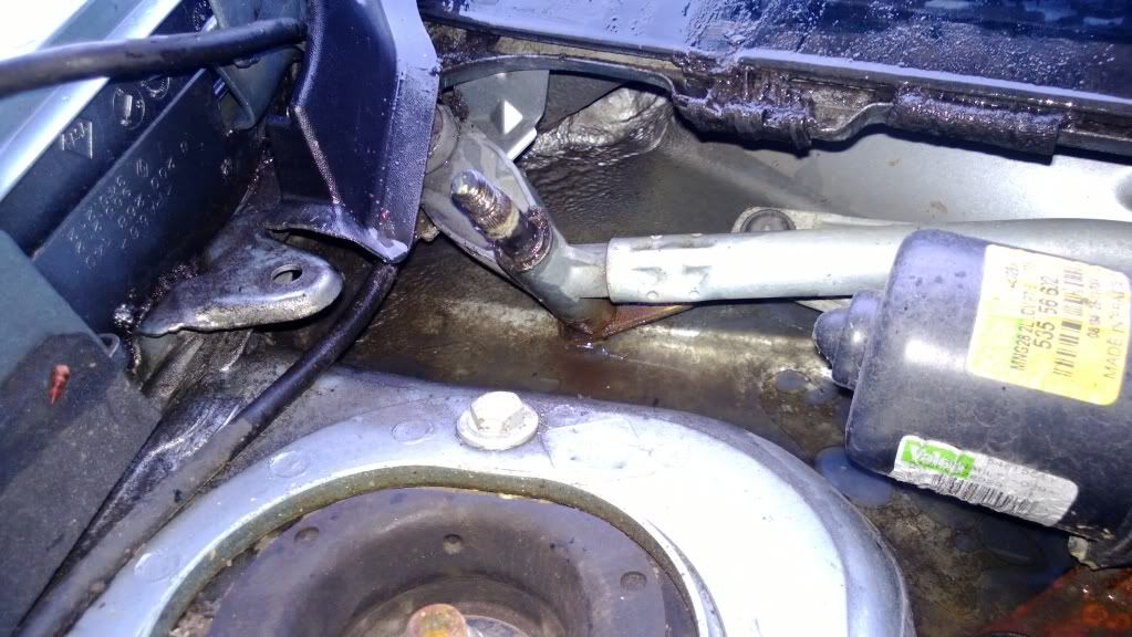

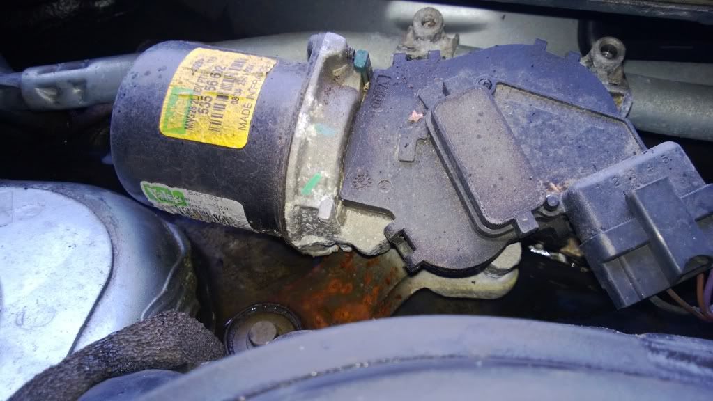

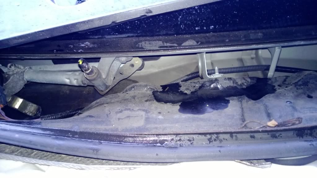

      First I removed the bonnet, windscreen wipers, scuttle panel and cleared the driver side drain (ripped out the drain rubber as it wouldn't clear). The drivers side drain was clogged and had a mini reservoir going on that was obviously spilling into the heater air intake above it! Bad bad bad design by Renault but now clearing water very easily.
      Interior

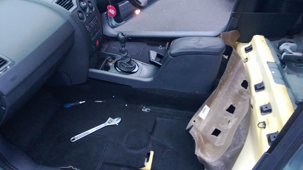

      There is a how to guide on how to do this but it apparently took 8.5 hours, MaxiTBird & I did the interior removal in circa 2 hours. The previous how to guide found https://www.meganesport.net/footwell.htm may have included drying time but just so others know, for complete interior removal that's how long it took us. The carpet and foam on mine was wet on the drivers side (front), slightly wet on passenger side (front) and slightly damp on the rears.
      MaxiiTBird's was wet throughout with mold growing in various places.
      We followed the same process and cut the foam pieces out strategically as removing the entire lot as one would cause us more time/hassle around the handbrake area. Three discreet cuts of the carpet near the handbrake and lower seat belt areas on both sides means the carpet could be removed. The foam was cut at points in the rear and front to remove parts but if doing so please bear in mind there are electrics all over the place hidden under the foam. Be careful not to cut through them!
      We have cleaned the carpets with carpet shampoo and sprayed the rubber backing with anti-mold spray along with the foam pieces affected by mold.
      The carpet and foam are left drying in the garage for the next week or two and we are running our cars without the carpet/foam with the seats put back in for convenience.
      The good thing about running the car without the interior for a week or two is that we can test whether any water ingress occurs during normal driving conditions before covering it all up again. It was tough removing the center console but other than that the process wasn't as bad as originally thought.
      I wouldn't want to do the process again on my car but glad I have done it. My problem was spotted and rectified in time before any damage/mold could occur. I have driven the car today with the heaters on full whack to dry out all the areas affected by the water ingress and the windows haven't steamed up once, confirming that the wet carpet/foam was the cause.
      Hopefully by this time in a week or so we will have our cars back in standard condition but we aren't rushing this, everything has to be dry and we have to be sure no more water ingress occurs.
      If anyone else needs to do this in future, post here or pm myself or MaxiTBird for assistance as we are happy to help out.
      Photos of scuttle drainage block (drivers side)

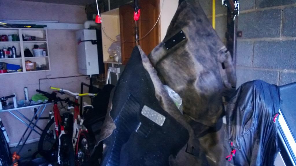

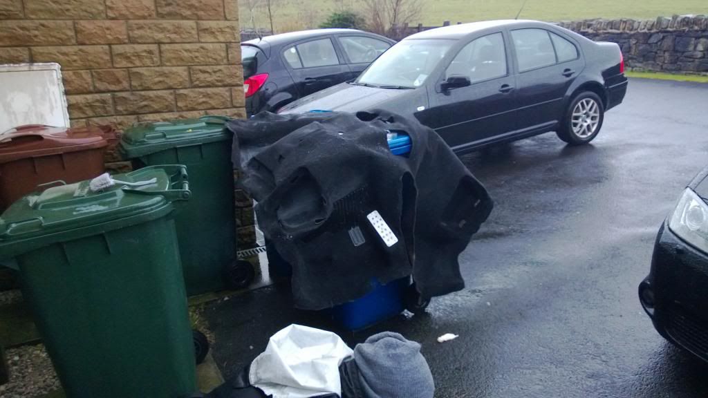

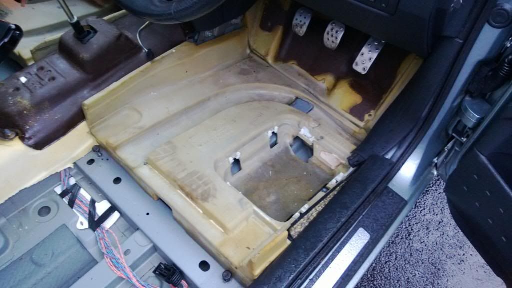

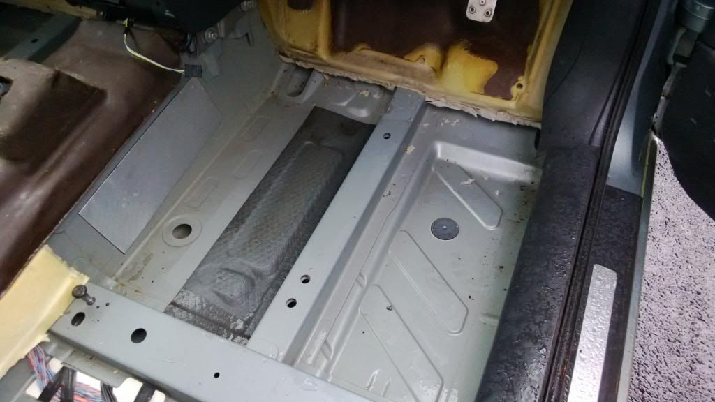

      Photos of interior removal
      Drivers side cubby hole was full of water, the foam was soaking wet with water in the footwell.
      Video of water coming out of drivers side foam
