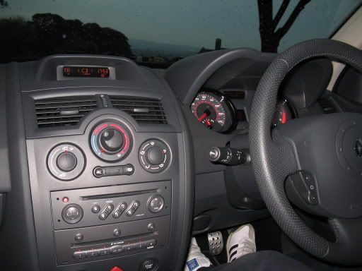

are they bringing out an adapter do you know? wanted to change my headunit but didnt want to loose the display really. I've got the Update List unit.
Yes this InCarTec company does one for the 'update list' megane.
But the only thing displayed on the display is the name of the maker of your headunit. For example if I installed an Alpine Headunit 'ALPINE' will be displayed.
Main advantage of the kit is allowing you to use the steering wheel controls.
In some of the renault accessory books its says about different headunits like VDO ones and sony ones. I wonder if Renault do an adapter themselves? so the display still works.
Renault do an adapter but it seams only the steering column controls work and not the dash top display, They do them for becker and sony stereos

I spoke to InCarTec yesterday and the new adapter should display the radio manufacturer name but also things like "Vol Up", "Vol Down" and "Mute". Basically most things related to a steering control related action. They don't seem to be able to interface with any head units changer control which is why nothing clever is displayed.
Its a shame they can't get together with Connects2 who can interface to get RDS/Track info etc, but who aren't very good at getting it on the display.
