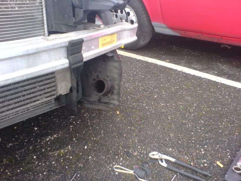

Well spent the morning tinkering and with an old lancia boost pipe and an aluminium pipe from halfrauds (£1.79-cos they priced it wrong :D )
I have bodged this together, looks tacky but it works it has improved the throttle response quite a bit!and it now has more sense of urgency!
cut a bit of trim off
the boost pipe on the ali pipe
the pipe onto the original
bumper back on!
· Registered
1,560 Posts
Didn't take long to get it off, thanks to Andy's guide!
the hole seems to feed air in really well so i won't use a trumpet, think its good as it is!

Hello mate
I was concerned about rain and crap going into the pipe, so sideways will still suck air into the pipe as it rushes into the front grill, and as you say isn't noticeable really.
As for a guide follow Andy's guide for the front bumper its dead easy!
then just remove the battery and tray.
remove the cover, then undo the battery +ve and -ve terminals (10mm bolt) tuck the leads out f the way
remove the battery sleeve (black plastic cube thing)
undo battery retaining clamp 10 or 13mm (forgot)
remove battery and breather pipe
remove battery tray(plastic one) 3 X 13mm bolts
you should now have enough access to work
You need a bit of an angle from the end of the OE air feed through the gap to the front end, but you cant miss it!
as for the hole i made where the lancia pipe sits(black)
just mark round it where you want the pipe to come thorough and cut it, but it is very robust plastic might need a drill and a jigsaw to cut it!
phil :D

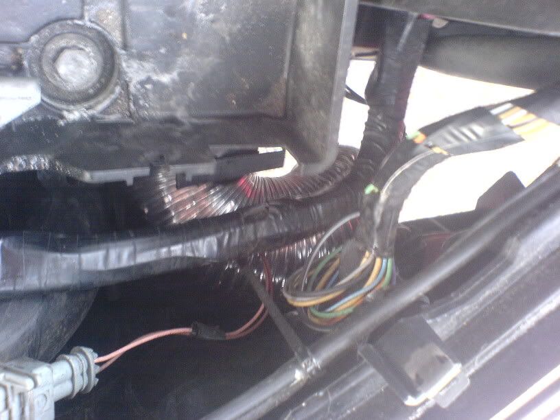

Discussion Starter · #18 ·
dools225 said:
Nice job Phil, might have a play with mine in summer when i can feel my hands outside! Where does the OE Intake finish mate :?:
Cheers mate, if you look at the 3rd picture down you will see the battery tray with the aluminium pipe going into it underneath, the OE coldair feed literally ends just under the battery tray toward the front of the car
phil
