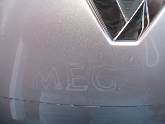

I recently debadged my 225 and have just gotten round to cleaning it. Tried a few things on the boot to clean it up (nail polish remover, white spirits and t-cutting it) but i'm left with 'meg' on the back. Picture below shows what i mean
It's almost like a the paint is lighter there. Does anyone know anything i could do to get rid of it?

your lucky i scratched mine with my finger nail lol, use the meguires clay got rid of my meg sign ....

yes just do it after youve washed leave it wet then lightly rub over your car then use a scratch x meguires then carnuba wax and looks just like it left renault :lol: :lol: :lol: :lol: :lol: :lol: :lol:

Used the clay on mine when I wiped it's arse, then went on to clay the whole motor. Superb gear :D

i had that on mine,
did your car get the supagaurd applied to it from new?? cause i put it down to that as it's applied after the badges, hence the shadow being left on the top of the cars laquer, mine has polished out tho and i used some of the supagaurd stuff in the pack i got :)
