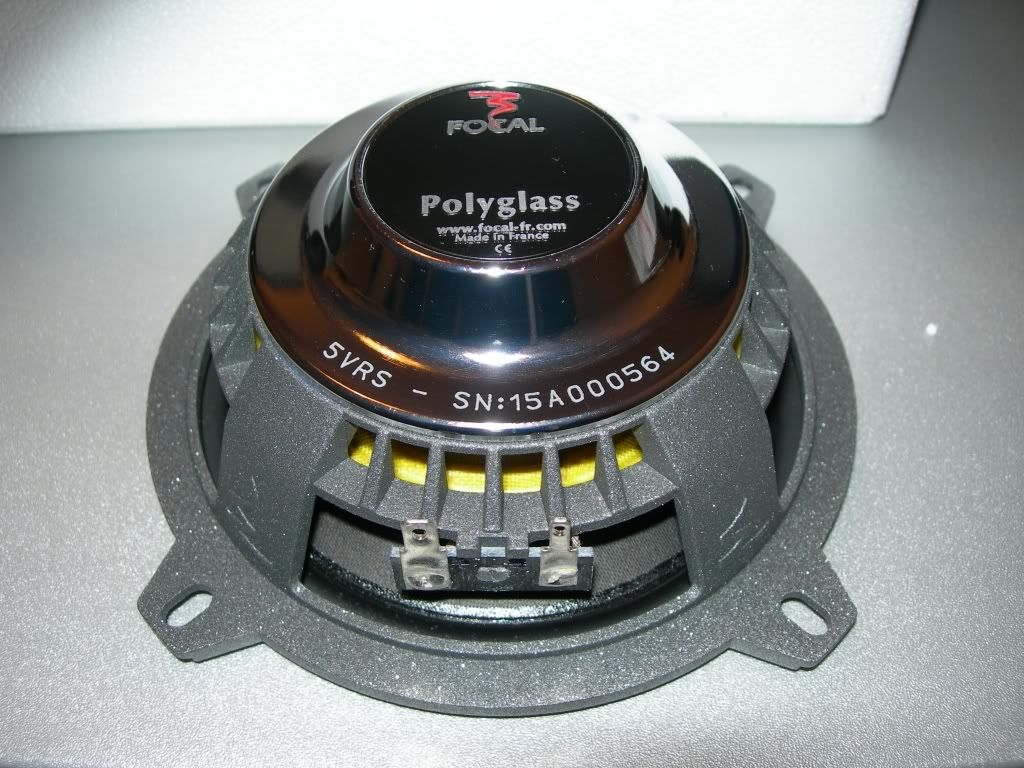

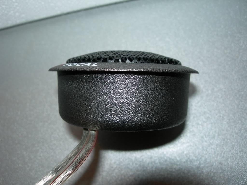

I fitted focal polyglass tweeters on mine, only needed to trim some of the scruffy trim that wasn't done properly in the first place and then pushed the case in fine.
I soldered new cables to the tweeters and ran these seperately through the dashboard and down to the crossovers in the footwell. I can go into connecting it up in a bit more depth if you want. Also have pics of speakers/tweeters/crossovers if you need a clue :eek:

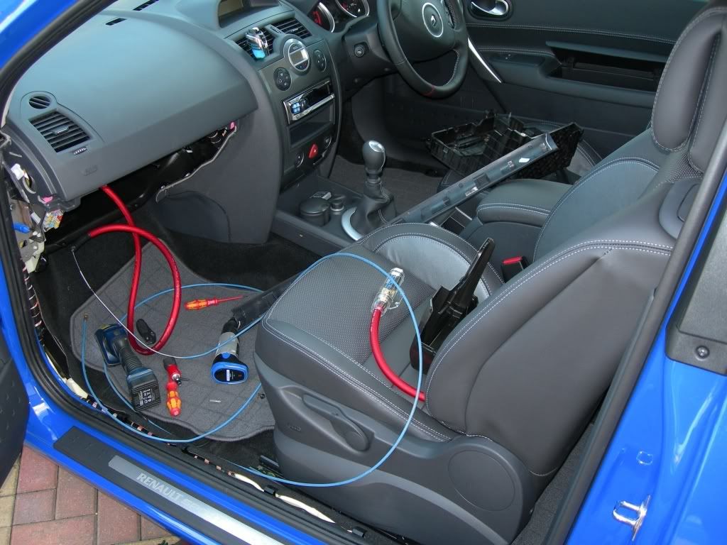

I used a mig welder gas hose that I had from work to feed them through the holes in the dash, a flashlight and some patience!
You can see the feeder cable here - http://i273.photobucket.com/albums/jj202/danparrott/Power2.jpg
Tweeter depth - http://i273.photobucket.com/albums/jj202/danparrott/Tweeter1.jpg
